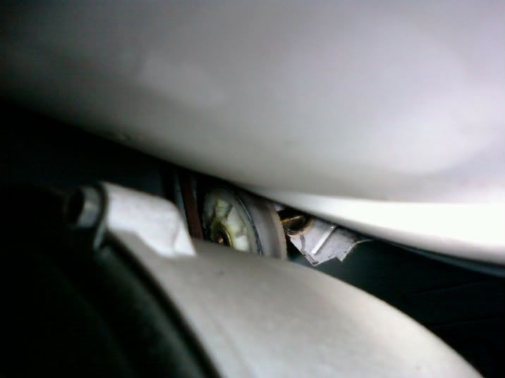

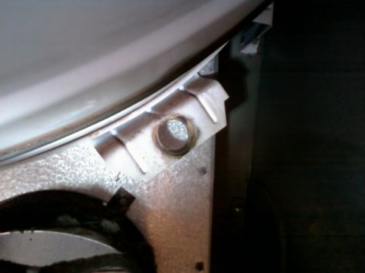

I looked at the drum roller and it was just hanging there, the sheet metal bracket that holds the roller will no longer hold the roller on there. The hole that holds the pin for the roller is now too big, it wore a bigger hole in the bracket, so it looks like I need that bracket, but I can’t find it on the parts break down…
Any ideas?
Here is a pic of the hole too big on the bracket
Here is one of the roller just hanging
