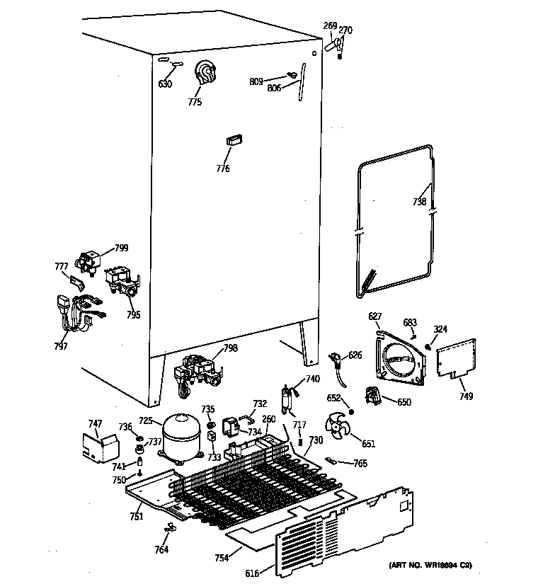

Remove the kick plate and the rear cover and clean the condenser coil (#730 on the diagram).

Lets do one thing at a time. If the condenser was blocked, wait about 24 hours after cleaning to see what’s going on.
