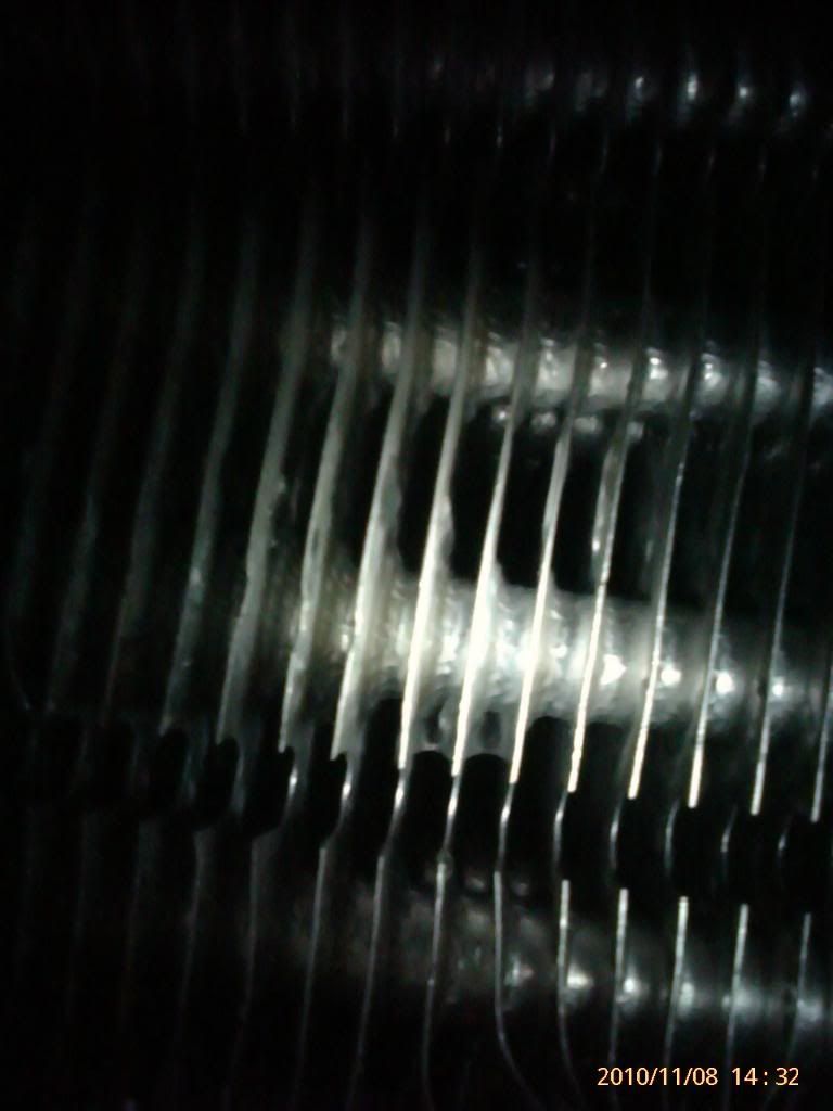

For a refrigerator that old, the diagnosis is believable. You can confirm this yourself by looking at the eveporator and seeing the frost pattern. If the system is fully charged, you should see an even frosting (just a thin coat) over all the evaporator, possibly extending slightly onto the cooling fins. If you see only a partial, or a "spotty" frost build-up, I would start saving up for a replacement refrigerator.
The evaporator on my built-in fridge is pretty hard to access and see directly, but I managed to stick my phone in to take a picture. It looks like there’s little or no frost, as you can see from the pic below. Looks like I’m shopping for a new fridge :frowning:
Thanks for your help though.
