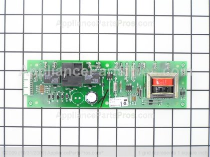

Thanks guys for all the good info, I think I am starting to understand a little more, One question, when you refer to main power board, ADC control board and control board item #9, are these same boards in the same location? I think I know the location of #9 in the lower left corner, front of condensor coil. I did not see any board in back of unit. Could it be in the refrige section
upper left corner?
All the same board:
http://www.appliancepartspros.com/whirlpool-board-p-c-12106802-ap4010827.html
