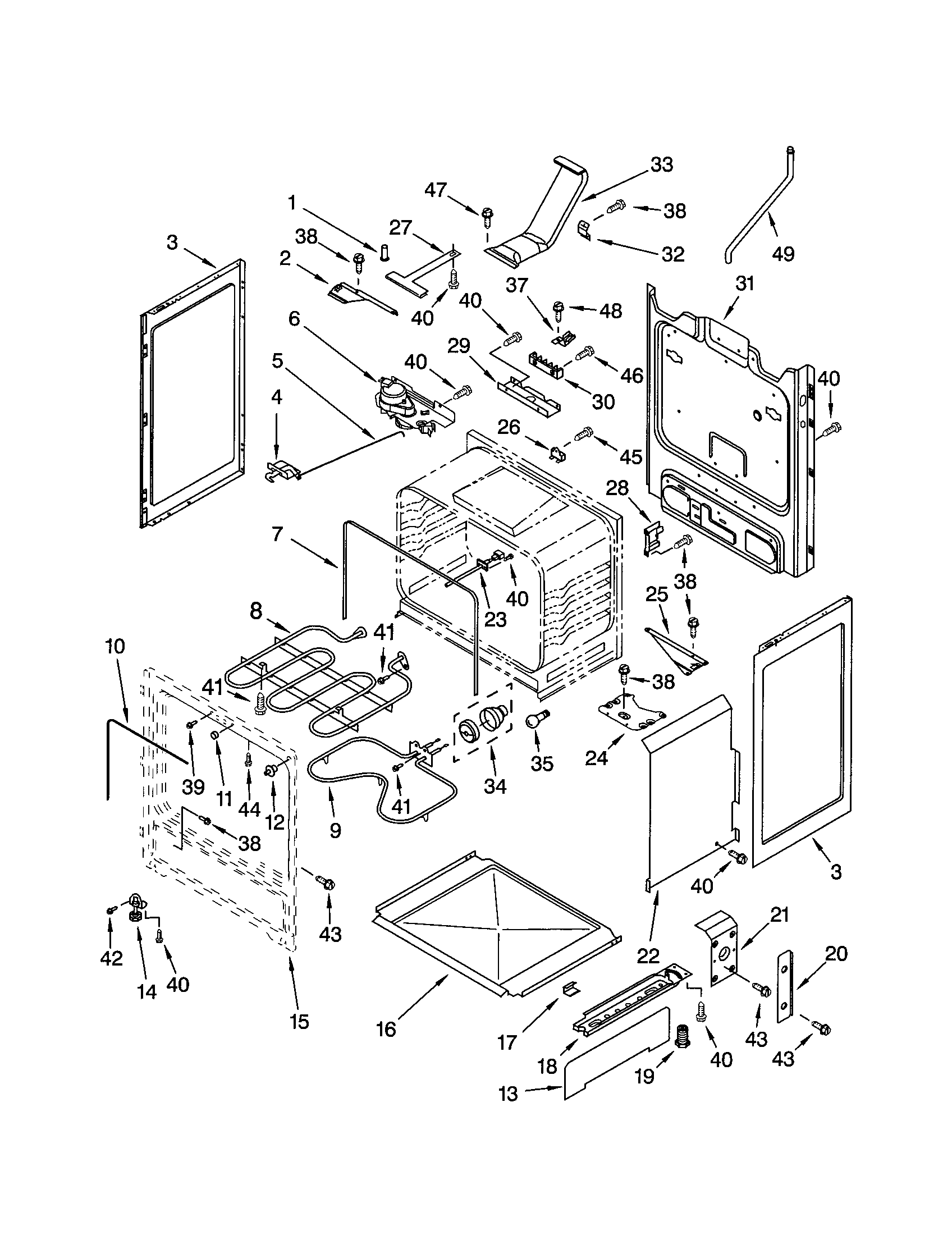

Pull the range out of the wall. Remove the rear cover and check the thermal fuse (#26 on the diagram) for continuity. Replace if it’s open.
If the thermal fuse checks OK, remove the wires from the Broil heating element terminals and check the Broil heating element for continuity. Replace if it’s open.
If the Broil heating element checks OK, replace the oven control board.
