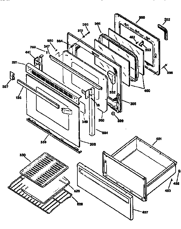

We just got the replacement glass from Appliance Parts Pros to go on the inside of our oven door. Could you please tell me how I can replace it correctly? Thanks!
-Adair
Adair,
Remove the door from the range as described in the [break down diagram](http://genet.geappliances.com/DocSearch/pdf/49-8783.PDF"]Owners manual[/URL] (page 27). Place the door on a flat surface with the door handle facing down. Remove the screws holding the door inner panel and then follow the [URL="http://c.searspartsdirect.com/lis_png/PLDM/10051906-00003.png).
