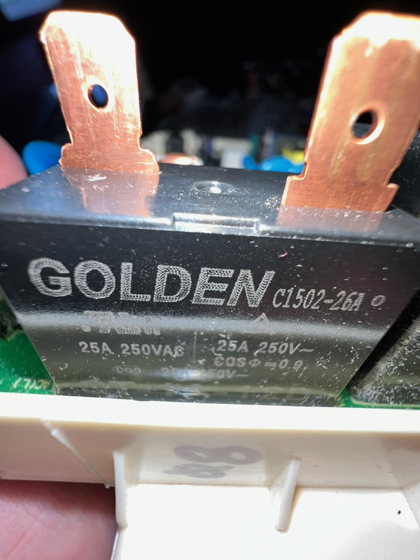

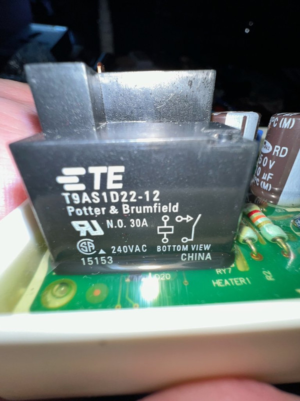

Do you believe it is possible that one of the relays has gone bad and could be replaced, so the old board could be used as a backup?
is there any way to test these?
https://i.postimg.cc/y6tXywqm/image1.jpg
https://i.postimg.cc/8PvdKtDq/image0.jpg
Thank you
thank you, i have ordered a main control board.
Thank you
