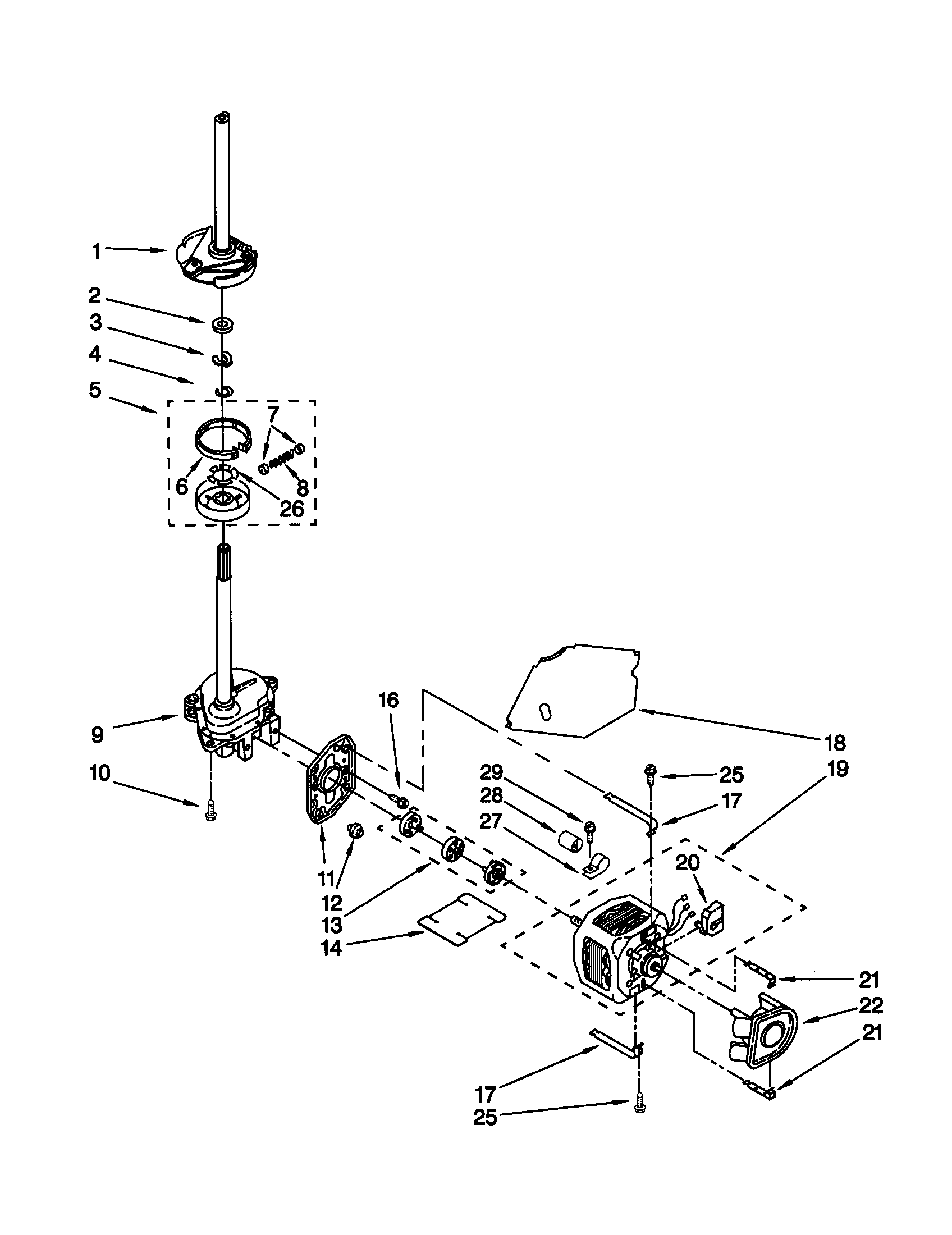

Hi all! I have a Kenmore Series 80 washer that has decided to stop spinning. Everything else works great, in fact if I open the lid and spin it by hand it gets the momentum to keep going and will speed up and finish the cycle. What do I need to do to fix this? Thanks
The first thing I would do is check the drive block (#15 on the [B]diagram. If there is nothing wrong then the problem most likely is a bad clutch (5 on the [URL="http://c.searspartsdirect.com/lis_png/PLDM/P8120069-00005.png))
You can find the instructions in one of our previous posts: http://forum.appliancepartspros.com/washer-repair/373-not-spinning.html
Perform the troubleshooting and post the results.
