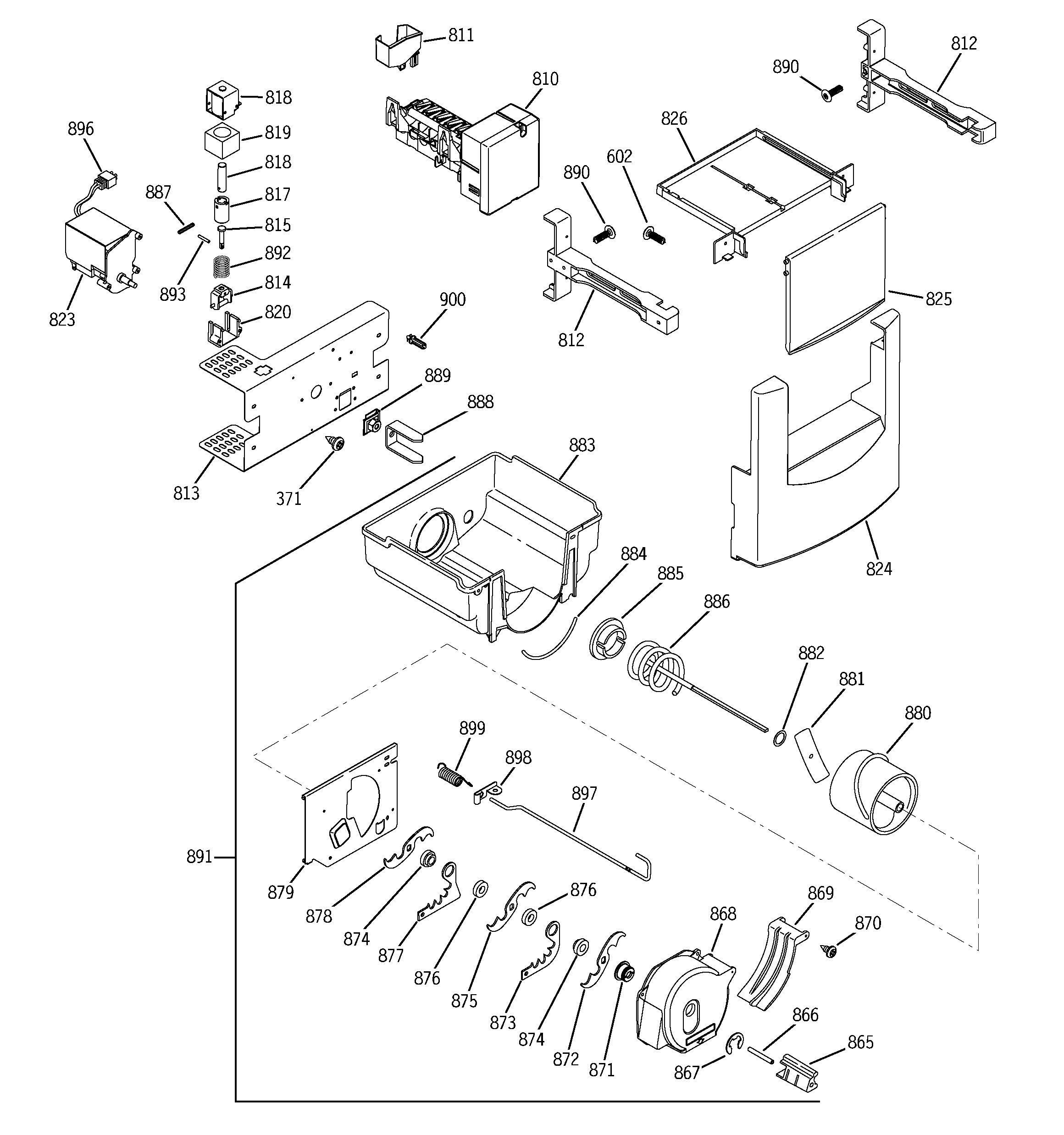

Mike,
You have to remove the ice bin, the ice maker and the cover for the motor & solenoid (#813 on the break down diagram). You do not have to remove the fork for this test. You can test the solenoid for continuity at the same time.
