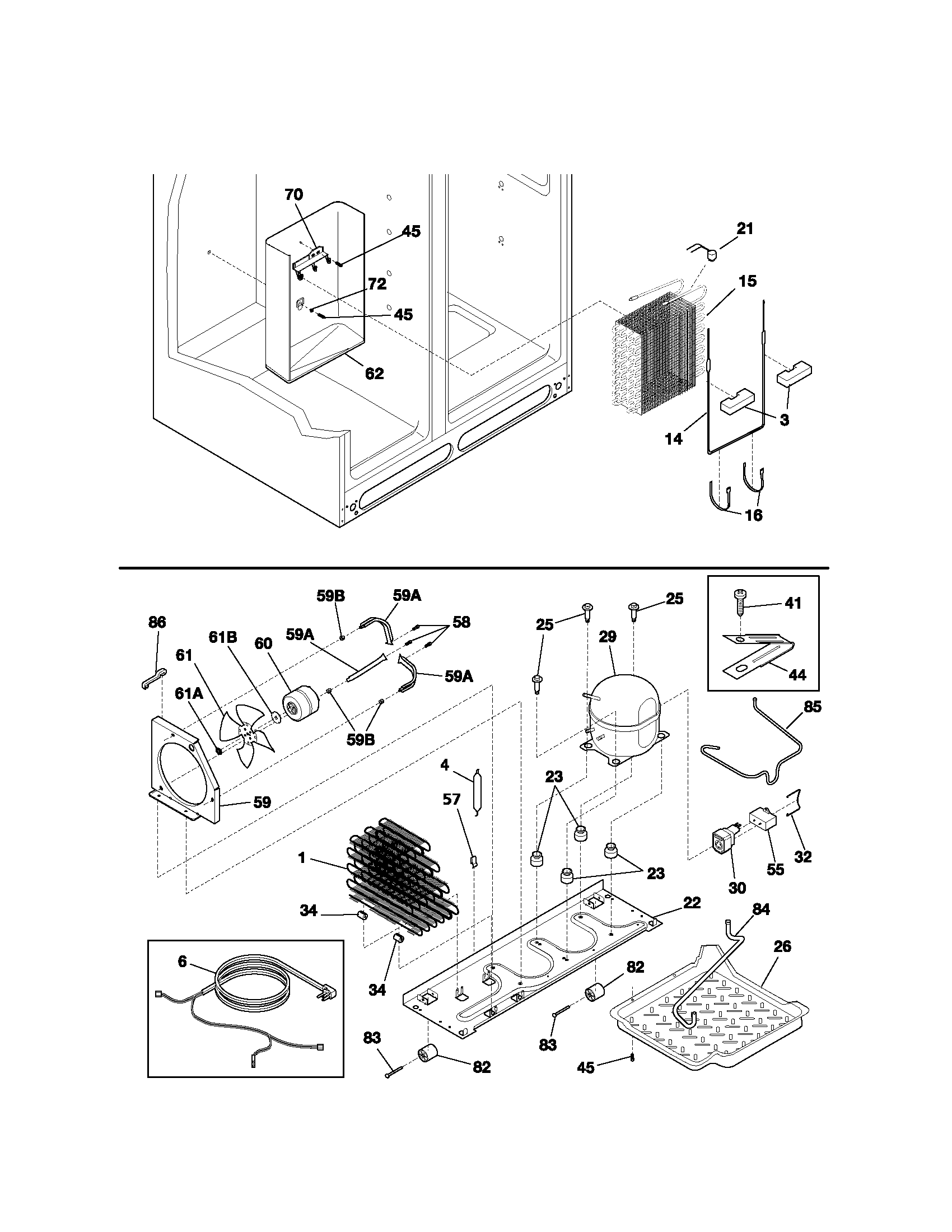

The compressor starter is probably bad since it finally does start. It’s part 30 on this diagram. http://c.searspartsdirect.com/lis_png/PLDM/R0201516-00006.png
