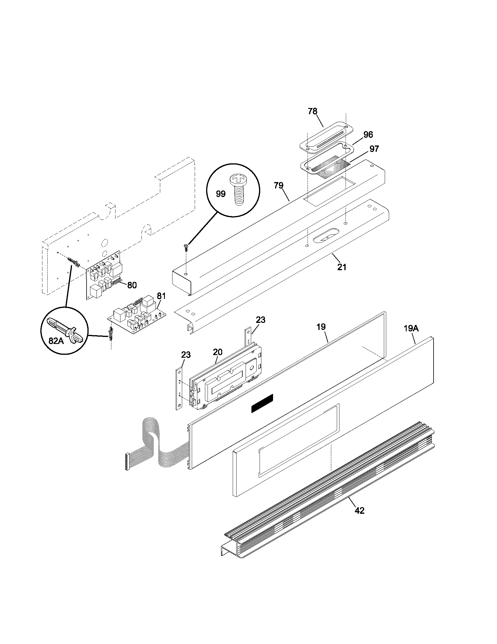

Assuming there is nothing wrong with the wires on the back, the problem most likely is a bad relay board (#81 on the diagram). The oven has to be completely removed from the cabinet for the repair.
