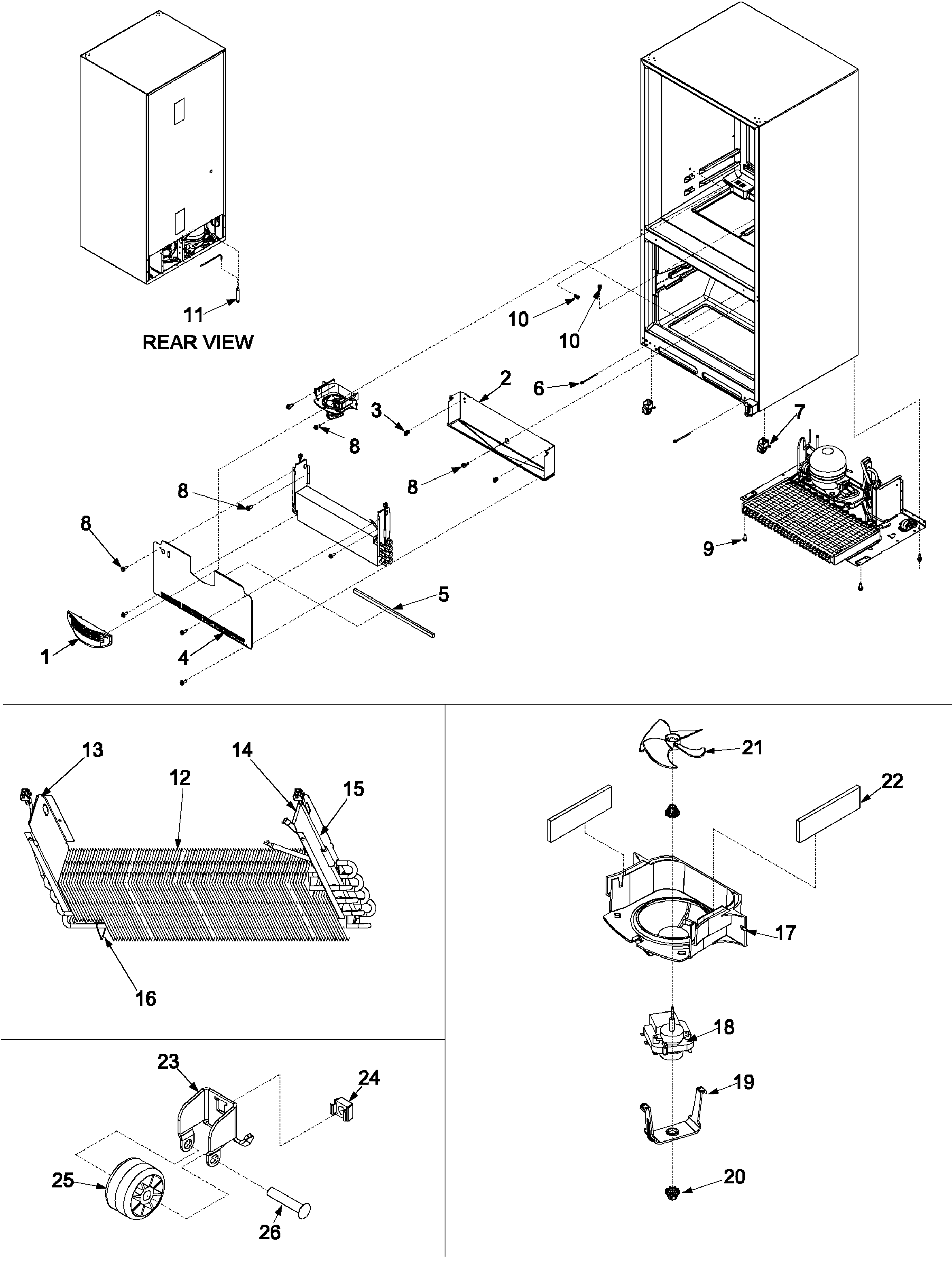

Looks like the problem is a faulty defrost system. You can find the complete troubleshooting instructions in one of our previous posts: http://forum.appliancepartspros.com/refrigerator-freezer-repair/4221-freezer-fine-refrigerator-too-warm.html
The defrost timer is 12 on the [diagram](http://c.searspartsdirect.com/lis_png/PLDM/M0209143-00003.png"]diagram[/URL]. The defrost thermostat is 27 on the diagram. The defrost heater is #15 on the [URL="http://c.searspartsdirect.com/lis_png/PLDM/M0209143-00006.png).
Post the results and we will help you with the correct part numbers.
I have located two parts on two of the diagrams, but there isn’t any 27 in the linked diagram (I found my manual and it only goes up to 26 as well). Any ideas?
This has been so helpful and as soon as I figure out this last part, I will try to figure out what to order. Thanks in advance!
