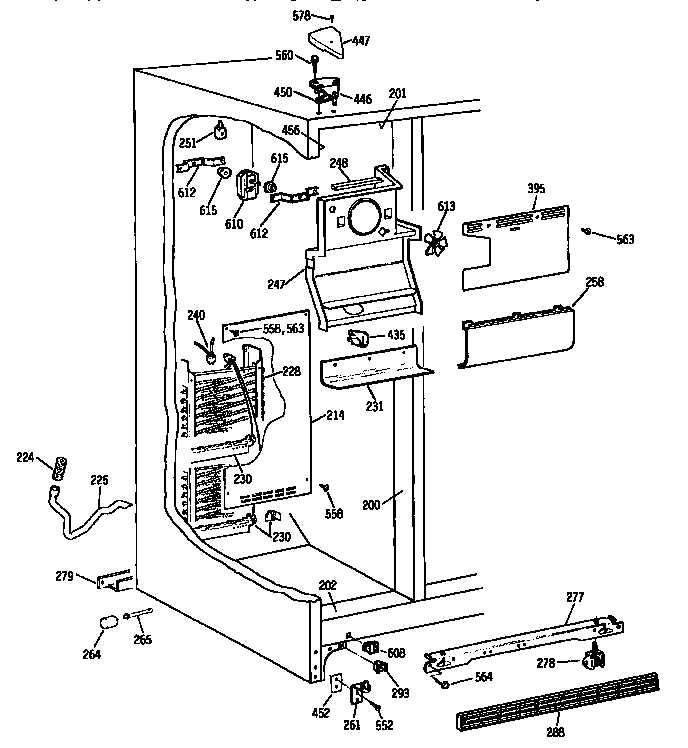

The defrost timer is shown as #257 on the [diagram](http://c.searspartsdirect.com/lis_png/PLDM/10033692-00007.png"]diagram[/URL] and it is inside the control bracket (#436).
The most common failure with such GE made refrigerators is a bad defrost heater (#230 on the [URL="http://c.searspartsdirect.com/lis_png/PLDM/10033692-00004.png)) which has to be carefully tested for continuity and visually. The new heater comes together with the defrost thermostat, so you do not have to order it separate.

I went home last night and checked the heaters last night and sure enough there was a bad one. I will be ordering a new one today. If only I would have wiped the condensation of of the glass surrounding the heater I could have caught this days ago. Chalk up another one to experience.
