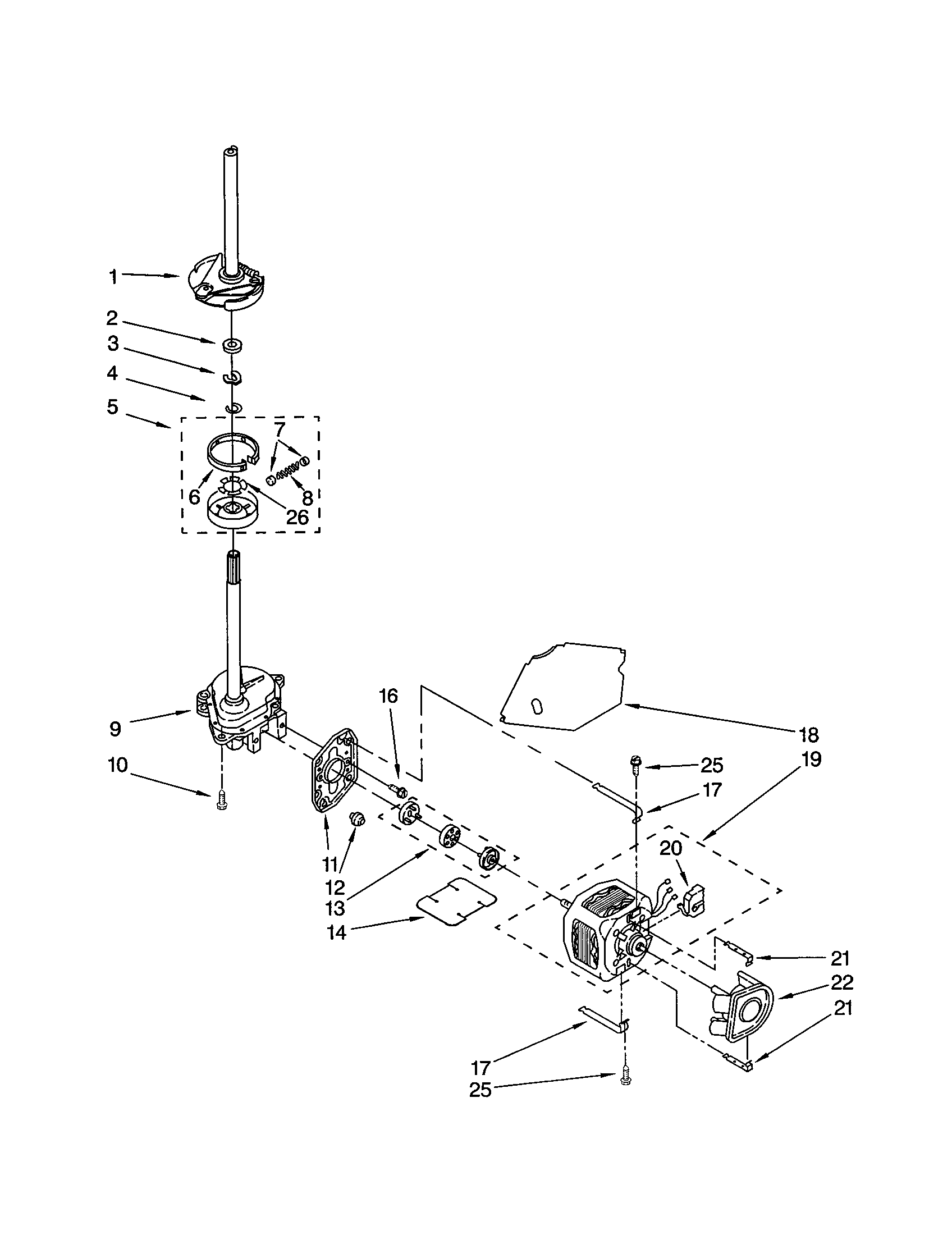

Oil from the transmission is not good, but the first thing I would do is remove the washer cabinet (the instructions are attached) and check the motor coupling (13 on the diagram).
If that noise was not from the transmission, then just refill it with oil and it should last a few more years. You can find some useful information on how to do it in one of our previous threads: http://forum.appliancepartspros.com/washer-repair/4929-transmission-oil-fill.html
