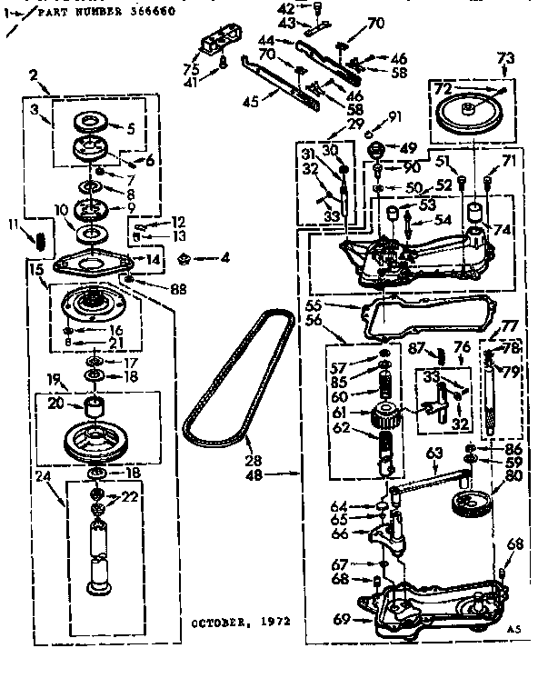

OK. so after a few experiments i can get it to spin or agitate but not both.
By manually resetting the position of the agitation bar and spin bar i can get it to start a normal cycle with fill agitate drain but then no spin.
Or I can get it to spin by manually setting the bars to opposing positions, but then no agitate.
so confused.
also, the brake (i think thats what it is) that spans the two bars seems bent. would that keep the bars from the correct position? What do the bars do anyway. they dont seem to move when its spinning or agitating.
Remove the rear access panel and check the wig-wag assembly (#75 on the diagram), the plungers and the wires. Post the results.
