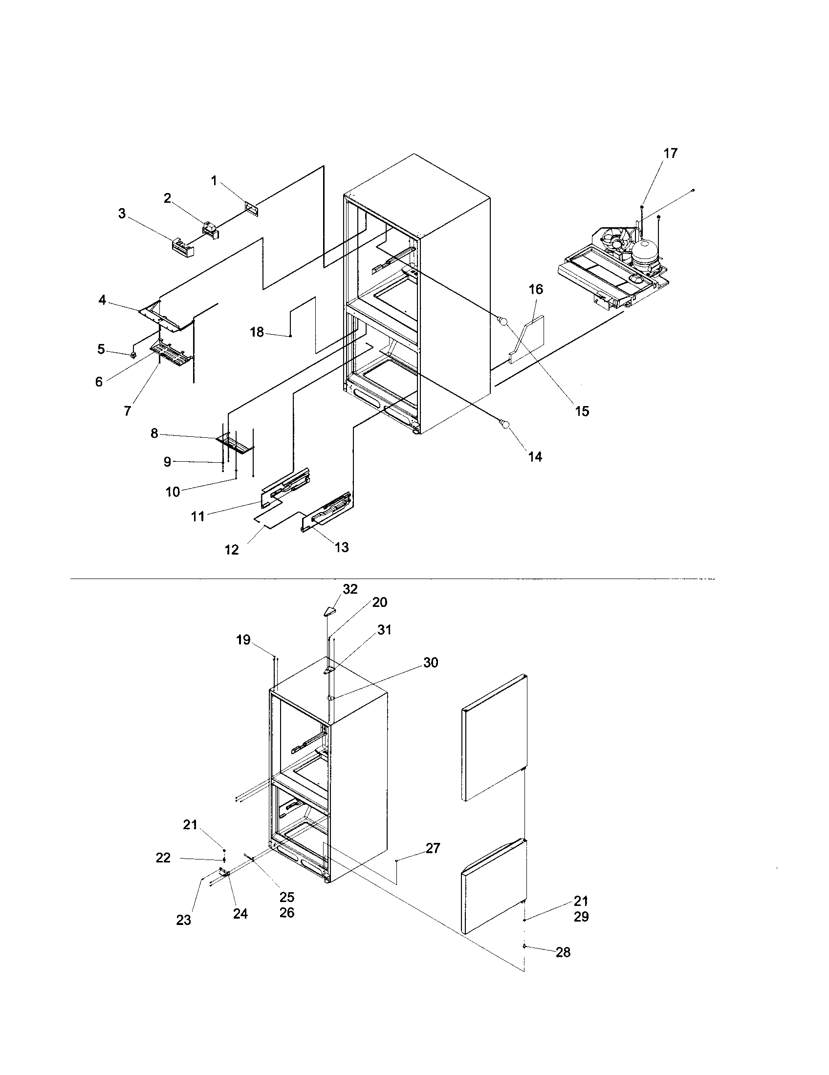

Remove the damper control (#2 on the diagram) and check if the gate inside is not broken or dislodged. Check the air channels for any ice inside.
— Begin quote from Gene;245697
  • The damper control [part]AP4247995[/part]
— End quote

I got the damper out, and it seems to be working fine. When the refrigerator was running, the damper was all the way open, as I assume it should be when the refrigerator is too warm. Is the thermostat in the metal box on top of the plastic damper?
